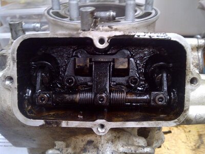

I had the excact same question, and wrote DASA.
This answer i got from Kyle was NOT to run castor oil, because it jams the power valve. Heres what he says
"After several hours of run time, the oil that dose not get burned and makes it way into the power valve area gets real sticky and causes the valve to travel slow or not at all.
Kyle
DASA Racing"
