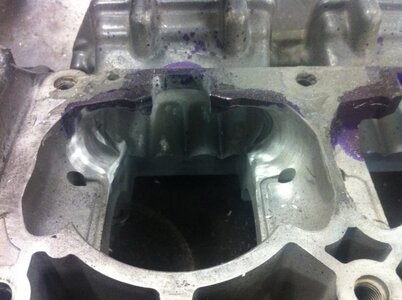

Here is the porting I am planning for the cases. Image courtesy of @waxhead .
