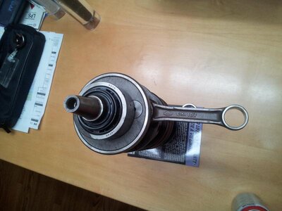

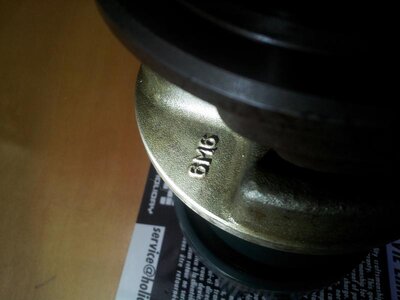

Your crank isn't oem, it is a hot rods crank. You will need to replace it.
I've been looking for info and pictures about hot rods cranks and I've not been able to find much unfortunately.
How were you able to tell it was a hotrods crank for sure?

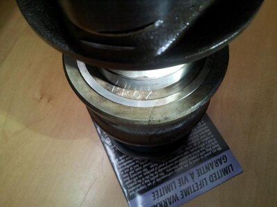

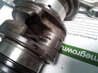

Upon further inspection I've noticed that hot rods is only on the rods, the actual crank has 6m6 and pro x on it but no other markings.
It just strikes me as odd that "hot rods" would only put their logo on the rods.
The info I've found says 6m6 is the "version" of 701 engine my ski came with.
Its also marked on the inside of the flywheel cover.
As for "pro x" I really have no idea.
Could the ski's previous owner have just switched out the rods when the others failed?
