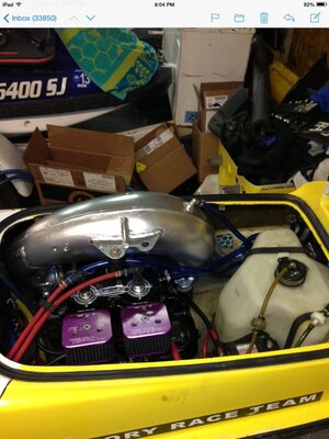

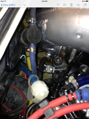

2 head fittings ok... On this Rn with parallel cooling we still used both outlets at the head... One line into manifold and 2 out head overboard
Had plenty of pressure and flow out the two head pissers and the pipe pisser. all 3 sprayed down the side of the hull out 90 degree pisser's evenly
You can see the black hose feed the pipe and below it is the silver clear bradded hose feeding the engine. 2 outs on head overboard
