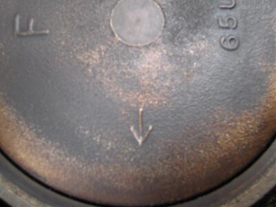

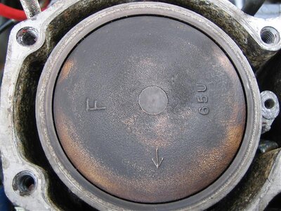

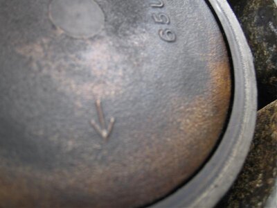

took the head of to have a look for detonation
how does this look (if you can tell from these pics)

hey i ran 225 on my hx with pump gas
i just made sure it got rid of the timing up top
you can make an engine live like that as long as you can control the timing
