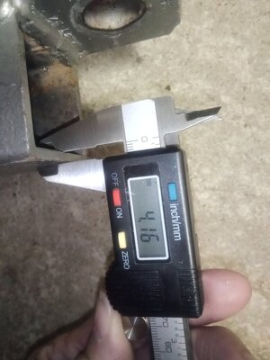

Here's the thickness of the steel on my motorcycle hitch hauler. Since you are building it custom, I would make the steel insterted into the reciever the full depth of the reciever for maximum strength.
Assuming your hauler is 2" square tubing, the thickness (4.16 MM to .164 IN) potentially is actually 3/16" steel (.188IN). Caliper may need adjusted. But I am going to shoot for 3/16 then.
