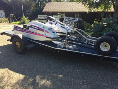

Found an old boat trailer for 100$..ended up adding pressure treated 2x6's for cross supports and decked it with 1" exterior plywood...covered it in indoor outdoor carpet..works perfect for 2 skis and the tote with plenty of room to spare...it's nice to have a platform to change/hang out on and could fit a few more skis on if I needed.. when I have to replace the carpet I will do it with turf..not running bunks right now but will probably make some with dowels in them so I can take them on and off easy...
Of course right after I built it a decent zieman popped up for 400$ but I'd rather have the flat deck...
