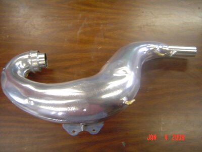

I see the ceramic coating of parts to be the best thing if you ride in salt alot and have the money. Tuning the pipe will be different because when the pipe sizzles it may be too late but you'll know for sure when the coupler fails and then at that point just add a liittle more water. Make sure you have all polishing stone balls out of the manifold and header pipe. I saw the Mckenna's have fun with that. Powder coating looks good but it will come off in a salt water enviroment even if your a clean freak like me.

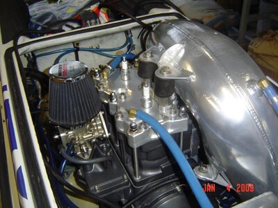

Also if you keep the heat down inside the engine bay you can produce more HP. Colder air (dense) burns better. I ran split cooling on my Stock Class SXR. This is a trick to try and have the skis run better. Late summer (95-100 degree's) I was still getting 49-50 out of my stocker wheras before I was lucky to get 48 when it was really hot out. Ran a dedicated line just for the pipe.
Same idea and result with the ceramic coated pipes. If you keep the heat down you can get more out of your motor. Not talking heeps but one of those things where when you add up all the little benifits you get huge gains.
bk,thats what i was talking about in my prev post. Also Ive found that tuning the pipe to sizzle isnt very beneficial for our riding style.the ski only turns a few more rpms and mph up top but the hole pipe has to get hot as hell,further incresing temps inside the ski.With a little more water outa the top screw its hits harder down low and mid and keeps internal temps down in the ski.initial response is really good like this also

I emailed X-scream to see what they thought I should change my screw settings too but haven't heard back yet. I did it more for the corrosion protection than performance so I'm not too worried. I figure the SS846 will have enough jam to get used to at first that I don't need to have everything dilaed in 100% right off the start.

Not thick enough to worry about, kinda like anodizing. The coating actually gets hammed into the metal surface so there's no thick builup like paint or powdercoating.
