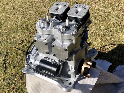

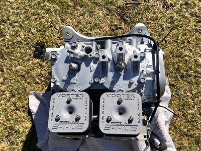

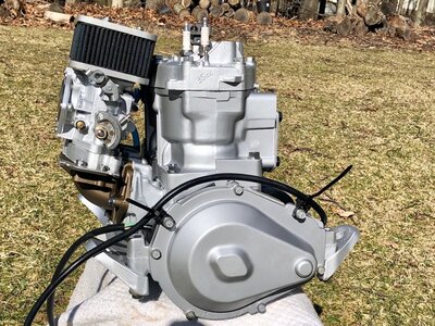

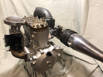

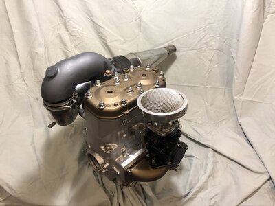

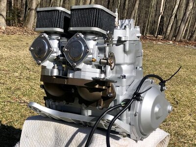

I used the air cure Glacier Silver (C-7700) and Burnt Bronze (C-148).
Each part was chemically stripped, any casting imperfections were sanded/ground smooth. Each part was sandblasted w 80 grit aluminum oxide, soaked in acetone, then Cerakoted.
Stainless and brass carburetor components were chemically stripped of the factory coating and either polished or left raw.
This stuff is supposed to have no known kryptonite, we'll see how long it lasts.
