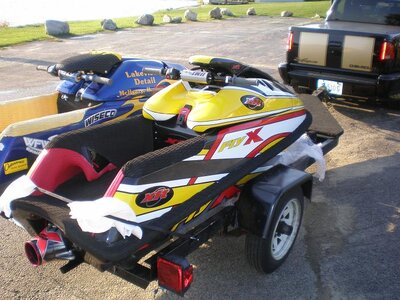

One thing to keep in mind is that his hull is a shortend lightweight XFT. -12 on a -3 hull is really like -9 on a stocker.
