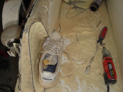

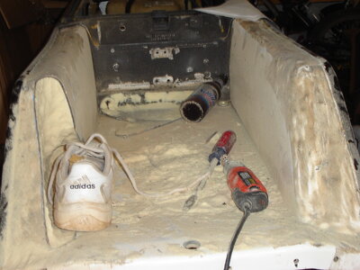

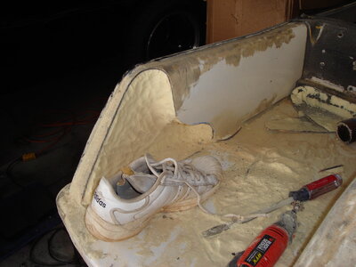

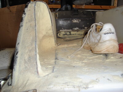

Thought of some crazy ideas...Took the stock turf off...than measured and started cutting...Than I had to go to class. But seriously it took about 30 minutes and a bottled nati (college budget) to get this far. Its a rough sketch but its going exactly as planned. They are going to be like the waterdawg X-series foothold without the $$$$$ of buying them. Basically, I'm going to have ankle cut outs and cups for the footies (I have tried and I like having my whole foot in a hold) To help mold the toe area, Most hobby shops carry quality foam that can resist the chemical reaction (heat) of epoxy. More to come tomorrow night!!!!! :Banane01:
-drimmel trayside to desired length and height of foot/shoe
-Glass the area on the trayside. *WARNING* you cannot use walmart resin because it will eat away at the foam
-JB weld hobby foam to ski
-Shape exterior block of foam to desired size and shape than glass exterior foam to ski
-Drimmel the inside of the foam out to shape of foothold (basically a sqaure rounded off at the top.
-lay glass inside in places that need strengthening
-instant foothold
-instant foothold
