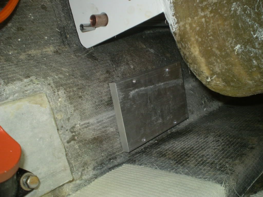

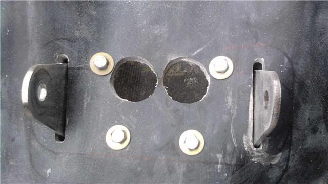

I did do a test on those strap inserts, those things arent going anywhere with just that epoxy and thickener. I pried and pulled on those things TRYING to break them loose and they werent moving. I will add a layer or two of biax over them to be safe. Now the battery tray on the other hand will be very built up, I can see how waternut had a problem with that thing with a heavy battery getting thrown everywhere the ski gets thrown I can see how it could break easily.

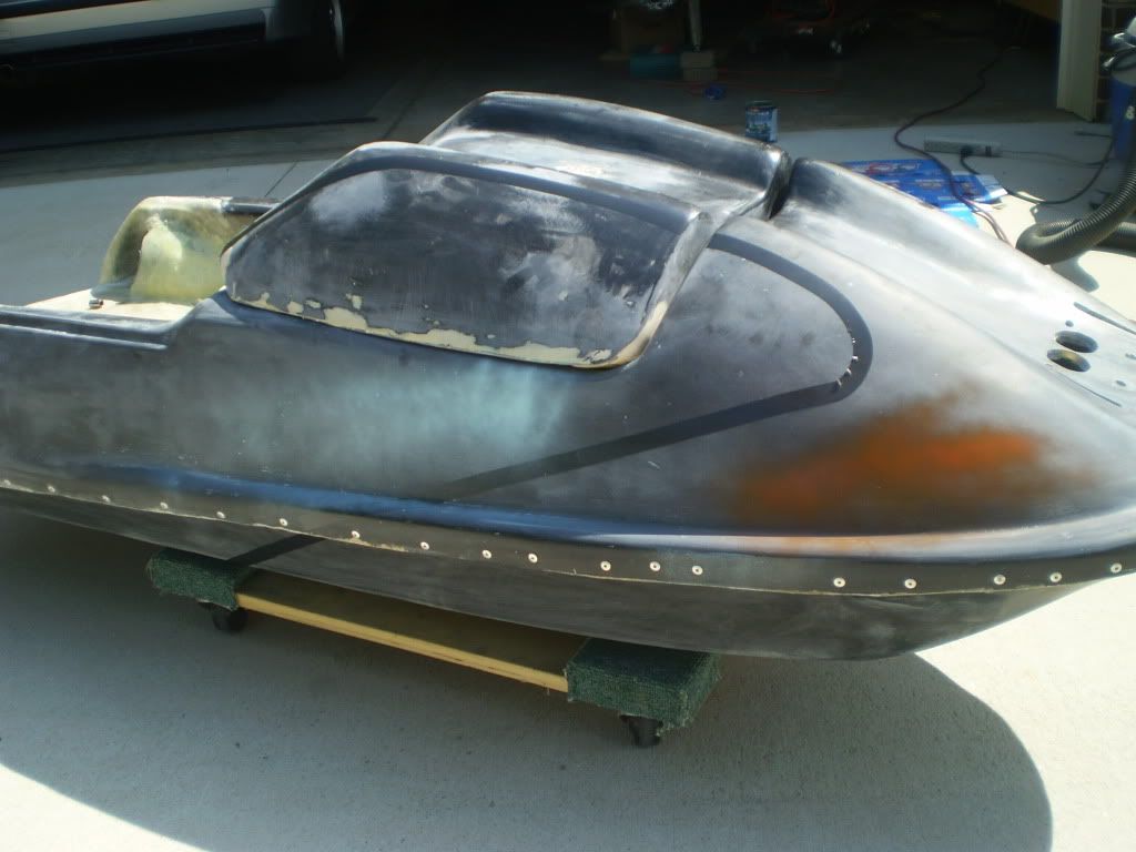

I just used the scuffed up gel coat as my primer but my paint was pretty dark and could easily hide any area that I used bondo on. Just a thought...
Well I have lots of bondo and light paint. It probably wont be that expensive anyways, better safe than sorry. I glassed in the strap inserts and added a layer to my enclosures to make them a tad bit longer. Just waiting on that stuff to dry now.

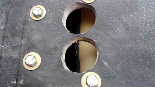

cut my breather holes\bolt holes. Obviously you can see my work isnt that great, look how uneven the pole bracket is when its lined up perfectly.
this might be a problemo depending on what hose i get for my breather tubes, if its stiff and not flexible I might have a problem. Hopefully I can find some soft stuff. Also I was planning on running the stock filler neck (obviously cutting it some) and gas cap but the hole will be extremely close to the breather holes. Dont know what to do about this one

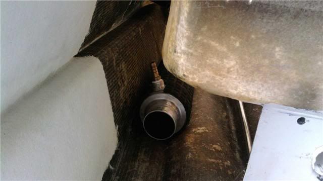

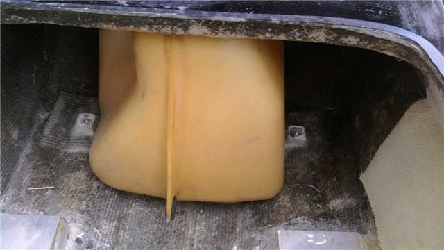

here is how the tank sits and how the inserts turned out

You can go down to home depot and get some pool hose.Black and blue looking.You can see some of it on my pole work pics.Inserts look fine! Why don't you either wrab the slincer in more matt material or in foam they use to wrap water lines? You could put a couple more inserts to hold down it down.l have some extra short straps if you want them.
I have plenty of straps. I guess I could make some more inserts. I just have to find somewhere local that sells that thick aluminum and then ill hhave to cut it and it will be a pain. I think I can rig something up without inserts. Ill have to look again at the pool hose. We have the same blue\black stuff but it seems really big. I think the breather holes are like 1 5\8ths.
I still need to solve my fuel tank filler problem. I dont really know what to do. My bracket seems to be in the same location as yours sanoman but your filler hole is like in the middle between the pole bracket and the edge of the hoodline. Mine would be right on the breather holes. I cant scoot the tank forward any because the hood rim would hit the pickups\cap.

l made some extra inserts.lf you want them,let me know.You have the same xmetal bracket l have.l used the hose from home depot.
l'm experimenting with my tank.l heat molded another filler neck off a 550 tank futher up the tank.(That is my little secret on where my external hose hole is!) lt reallly should stay together.Used the same method before on repairing a tank that had a hole in it.l would not suggest doing this way until l can go beat on it for a while.l'll keep you posted.
