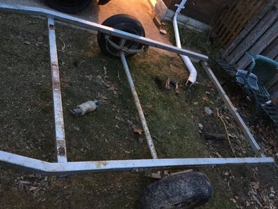

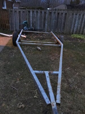

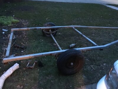

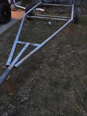

This is what I have to work with as of right now. I've ripped it down to bare frame. Image1459382982.092972.jpgImage1459383001.727702.jpgImage1459383008.824512.jpgImage1459383020.562511.jpg
Now I just picked up a tool box for the front v portion it's 70 inches wide so it'll span the who front of the trailer. Here's where I don't know what to do. Do I weld new 2x2 running with the two that exist already to bring in level and add a third over the axle. Or do I get bunk holders that are adjustable and just use them?!
If I make everything flush with the top of the trailer I'll get some "U" channel weld to the frame of the trailer and put my 2x6 in them for bunks. At this point I'm unsure what to do. Any opinions would be greatly appreciated

I could do so many things with that setup. You have a great platform to start with. How many skis do you want to haul? 2-3?
Fuel racks plus tool box? If you want to send me some dimensions I can draw you up a cad model to work from.
hhh
I edited my post check that and if I can help just let me know. Wish you where closer. You could drop it off and I would build you a killer setup.

More help the better. I have it planned out in my head. It's just the gp is a biiiig girl and every time I'm set and I think I know what I want I look at the gp and realize she's a big bitch haha.
