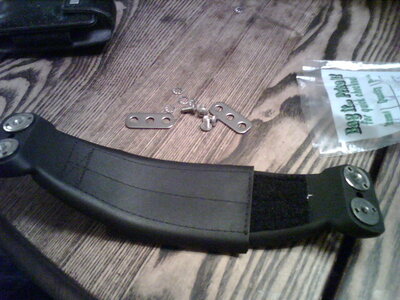

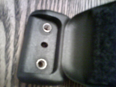

The DAKINE Supremo Footstraps have a rubber end that fits over the stainless barrel that's the same height and then the stainless plate bolts on top with 10/32 pitch 3/8" length screws for a perfect fit.
They almost work too well and give the impression of being like they should almost come with the straps.
So I just go pick up what 2 or 4 per strap? Then epoxy it down before turf and then the barrel fits in whichever hole I choose in the Dakine's and I put in a 10/32, 3/8' screw with nut and I'm good to go?

peeps have more pics i will recive the straps on monday and want to see some pics of the install i will prob go with the ace harware style washer with nut.

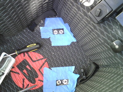

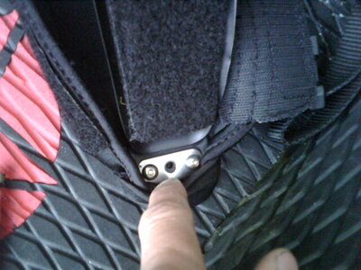

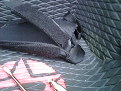

installed
cut hydroturf in desired location size of dakine bottoms.
acetone clean bonding surfaces
mark off with pencil area for the nuts washer

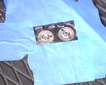

use 2500lb 2 tone 2 part clear epoxy syringe type ace harware. 6$ 2hr
coat bottom of washers lay them down and coat around the washers- see pic.
once it starts to gel spin the nuts in to clear a path so it doesnt dry and block
let dry 4 hr.

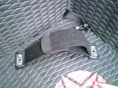

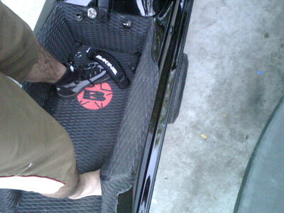

install da kine
make sure you get screws that dont go past washers it will protrude and mess up the epoxyed deck area.
it is very strong and should hold up 2500psi epoxy
