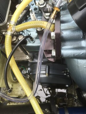

Ok I threw in the 2.3 needle and got the popoff at around 14 psi. I also realized I had my primer feeding off of the fuel inlet and not the fuel return. I got it routed correctly. Maybe the primer was letting air into the feed line.
Instructions for the primer I installed said to T it from the reserve line
hope you get that jetting worked out
Bishop CA
The primer kit I put on was for a snowmobile so the instructions said to T to a fuel line, so I did.
However, I did run it on the hose after making my last changes and the BRAP is back! I can't wait to get the old Blaster back on the water!

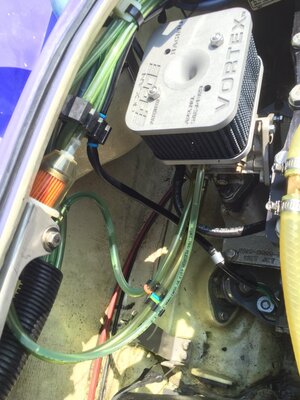

So the filter height on the vortex filter is pretty tall, about 2.5" tall. I'm thinking of restricting the airflow by placing a 7/8-1" strap around the outside surface of the filter. I'm thinking this should add some resistance and hopefully help boost the signal a enough to eliminate my big end starvation. This FA is a clean setup that makes everything on that side of the motor easy to get to. I'm big on making things easy in the long run. I demonstrated this with my setup to check for air leaks. No more having to remove the pipe! My laziness lead to a pretty cool and cheap setup!
I guess I'm just not ready to give up on the OP intake quite yet. I wish Ocean Pro just made a lower filter element but this Jerry-rig will hopefully take care of the issue. When I go out to test I'm going to bring my factory blaster FA with just in case along with my pilot and main jet collection! One of these days I'll get this thing dialed and it will be glorious!
Any thoughts?
Quinc
Buy a Superjet
California
That air filter should be fine. I ran it on my 46 when I was getting 50mph +
How hot is the pipe getting while riding? Maybe she is getting a ton of water dumped into her? Also search on groupk. I believe they talk about this issue.
Bishop CA
The pipe gets warm but you can hold your hand on it. I bought some inline ball valves to adjust pressure but never installed them. You think it's filling the pipe with too much water and that's causing the motor to loose it on the top end? Idle to mid rang seems pretty strong.
