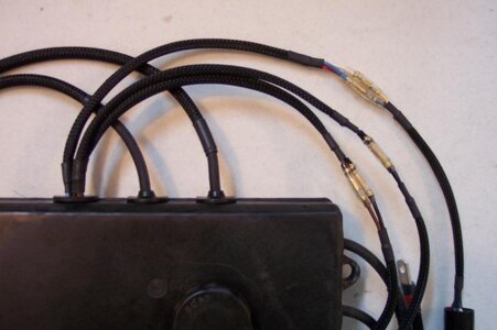

Anyone have a pic of their harness in the ebox??? I'm going to be installing all this stuff next week and have glanced at everything and am a little confused. Am i supposed to be replacing one of the stock rubber deals with the new harness and just squeeze in the existing wire??? Also has anyone mounted this switch through the stock dash stuff? I know most of yall have removed the stock plastic thing and turfed but i'm not yet there to install holds and returf.

Here you go, the first pic is a dual harness kit installed with a single oem fuse. If you install both fuses, (recommended) then you should trim the tube off the inside of the cover to get enough clearance.
I have not snapped any updated pics to show the install of the temp probe delete kit but it's pretty simple. Unplug the temp sensor pink and black wires and replace with the supplied plug which consists of a male and female terminal crimped onto a short length of o-ring material. The temp sensor assembly with grommet can then be removed and the new harness fitted into the same grommet location. The white, blue and brown wires all connect together. The black wire connects under the same screw as all the other grounds and the red connects up to the same terminal on the solenoid as the battery lead and oem fuse.
