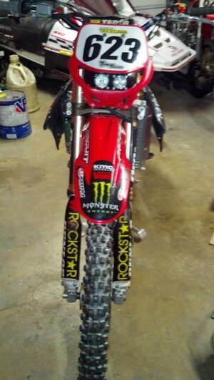

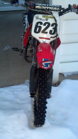

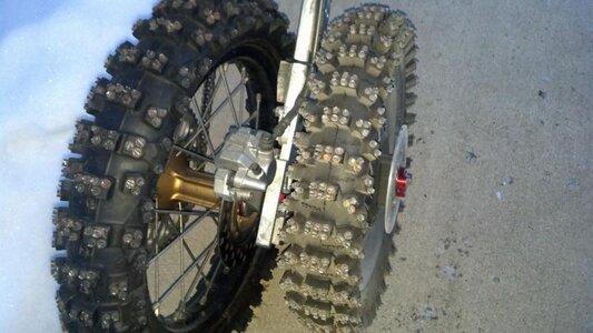

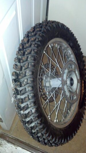

We finally are getting some cold temps to get some good ice. Hoping to get out on the lake next weekend. The lakes are almost glare ice, perfect for the bike. Finally get some riding in, tomorrow or Thursday might be a good day for some PTO.
KX 85 rear 15" wheel or klx 110 12" rear BBR for only ice (no rocks)
RMZ 85 Front 17" or 14" klx 110 front Marzocchi

Looks like you did a good job. I bet they hook up good. Its better take your time and do it right, in the long run.
On the dirt bike you have braking studs and acceleration studs, street bike tire on the inside so the 1" studs doesn't pop the tube. The bigger tires on my mini just have half inch in the knobs, good for cruising but doesn't last
long and will eventually tear some of the knobs off.
