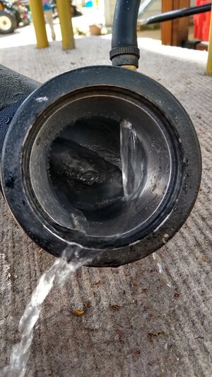

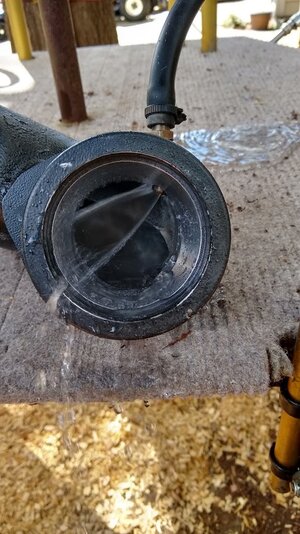

Installing my tnt v2 lay down pipe with sprayer on the manifold. And wonder if better to have the half moon sprayer with a wider spray pattern or a straight shot of water from an npt fitting? Pics where taken without the 120 jet in the sprayers.
watcon/coffman sprayer. Any benefit to the direction of the spray; Across manifold vs Pointed toward chamber?
Straight shot (stream will be smaller with the 120 jet)

Spray with the direction of exhaust flow.

Thank you for the reply JR! Spray bar it is.

Use a spray bar pointed directly with the direction of the exhaust flow.
