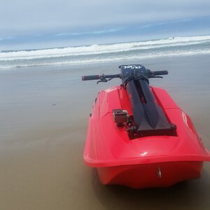

Look up aura I have one on my aquabot it's universal from Yamaha and kawi.

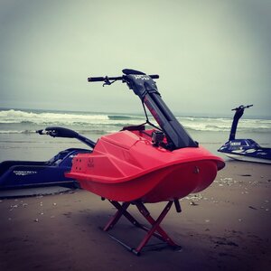

pic cried @yamanube lol I stole them . Kp pole on his ski . The guy's name is @Knoxie on here

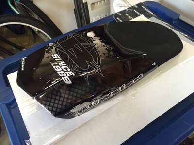

I'm currently waiting for the delivery of my new matrix and I choose to go with the blowsion handlepole setup. Yes, the Blowsion setup is not cheap but you get what you pay for, it has the OVP steering, it's super strong, lighter than the rrp billet setup, CNC work looks amazing, and it's USA made. RRP poles are nice but this is not the 2005 anymore. All RRP stuff is built overseas and they still charge a fortune for it. Just about all the other poles are knock off RRP setups and I wouldn't spend my money on those either. Personally on the SXR I think the xscream pole looks the best but I can't comment on the functionality of it. Good luck

Agreed, the Blowsion is a sweet setup with amazing quality and workmanship. I would own one if they didn't CNC their logo all over it.
