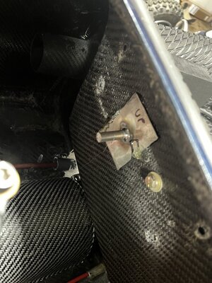

Had a buddy weld up these little stainless doodads and hacked the heads off the bolts and ground them flat. Using 3m panel bond for the backs and hot glue to hold them in position until they set. Then I’ll probably throw about 3 circular layers of 6oz carbon over them and we should be ballin’
