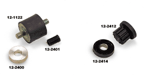

I know we can get the lord mounts for B pipes on McMaster Carr, I'm having trouble finding anything on there like what Protec uses. Anyone have any luck getting them elsewhere? I need all the hardware for this pipe and just tryin to save a few bucks getting them elsewhere.

You dont have any part #'s do you? Ive searched on there and cant find anything... Although I'm sure im not using the correctly terminology for their parts.

I dont know for sure exactly what they look like but from Pro-tec's website I pulled this picture and looks like what I need. (one to right are what Im having a hard time finding.)

Get something other than the ones on the right even if you get a solid piece of rubber and drill your own hole in it. It will be better than the protec ones. Those things wear out so quick

It looks like polyurethane bushings for cars will be the best bet. The issue I have now is not knowing exactly what size to get in terms of overall length, height of the flange section along with the diameter of it. If anyone has some mounting hardware for a protec and could take measurements I would owe you big!
I bought one for my coffman sizzler that looked just like that. It's an oem part from a kawi 650 exhaust mount. It was like 8 bucks or something like that.
I know I'm bumping an old thread, but did anyone ever come up with specific part numbers from anyone? ( McMaster, Grainger, et.), for the rubber dampner mounts? I've got a waveblaster pipe I want to install and the $135 that Pro-tec wants for the hardware kit seems really over priced! Thanks in advance for any help!
After more research, I may have found the answer. It looks to be a Kawasaki OEM part number 92160-3702 and the washer 92160-3701. They look exactly the same. Partszilla has them for $3.50 each. I'm gonna order and try them out and I will let everyone know.
I tried the OEM Kawasaki part number 92160-3702 that was used in the original OEM pipe on an X2 plus numerous other applications and it is a perfect match and exact fit to the Pro-Tec piece.
