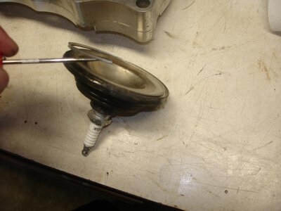

Super Jet Anyone ever seen this?
Ohio
I could tell I had a bad Oring on the head so I pulled the head and found that issue but I have never seen this. It is outside the combustion area and once the head is torqued down it shouldn't be an issue, right?

Yeah I had a dome on an ADA head go like that - but only when my builder made the O ring grooves larger to accommodate the O rings he had in stock, I took the boat on a 10x day skiing holiday and it failed on day one like yours. Holiday over for me, really pissed at him when he admitted what he'd done!
unless that outside ring is totally supported, especially where the end gap will be, the O-ring will push out and not seal correctly. its basically junk, unless you like pulling the head off all the time to replace 0-rings.

Ok thanks guys....I need a dome or a set of domes then!

I would buy a set of domes and make sure your head is torqued properly. If that dome was chattering in there the head shell might be shot too. A new shell and domes would be the safest insurance. I'd go 33's on a ported motor. P
