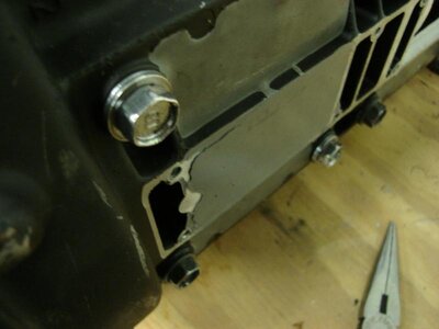

I just pulled the custom plate off the bottom that Brian at DASA made to hold the epoxy in.
Funny thing, they told me they NEVER had a superjet drop the epoxy out of the cases....
One side the epoxy came out with the plate...never really stuck to the cases and the other side is already showing cracks between the epoxy and the cases. This is on an epoxy job that has NEVER BEEN RUN.
FYI when you go big stroke you lose the bottom of your cases and count on machined epoxy to stay in place.

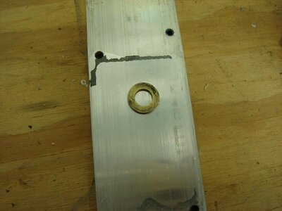

So after removing the plate I turned the motor over...and it stuck in a different spot. Looking in the hole in the bottom of the cases.....I spy a WASHER in the laying in the case under the #2 cylinder.
Thanks for the spare head washer DASA...I would have preferred to have gotten it OUTSIDE THE MOTOR.
I'll post pics later, you can see little circle marks on the epoxy where the washer was caught between it and the rod.
Washer removed and now it turns over.

Pics. First pic you can see the washer. Second pic is the epoxy already cracking off the cases, Third and fourth pics are the epoxy stuck to the plate Brian made, see the little half circle dents from the washer?
Aaron

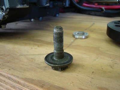

I needed to pull the flywheel bolt out to install a degree wheel so I could make some timing marks.
The flywheel bolt was WAY WAY overtightened. I had to take the engine to my real shop to use the BIG air gun to get it off. I would estimate it had over 100 ft lbs on it considering the effort it took from my big gun.
BTW this was a new bolt when I built this motor.
Once I get the bolt out I find out the last couple threads are GONE. Still in the crank presumably. Yep, confirm that the bolt will no longer go all the way into my 8mm stroker crank.

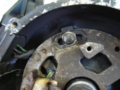

Then I noticed my stator (yes I know it looks like it has seen better days, and the Advent CDI doesn't use the missing coil)). When I sent the motor in I had the special JSS stainless steel allens and the special cut washers holding the stator in place.
I guess Lamey liked the bolts, because the took them and replaced them with some non-stainless crap. Looks like the idea behind the specially cut washers was too complicated for Lamey too because they installed them WRONG.

See pics below.
Aaron

If I were to make an educated guess based on my life as a machinist, I would say the flywheel wasn't on too tight or overtightened, the problem was the bolt galled when it bottomed out in the threaded section of the crank and it was screwed in without either tapping the hole deeper in the crank or shortening the bolt. Either way there is no doubt the workmanship was/is sloppy and a complete embarassment to the the way things are supposed to be run at the shop.

I could respond via PM, but it is important to see that DASA does make mistakes from time to time, as does any company. In this case, several on one project. It is no doubt an embarassment to everyone involved.
The preliminary story I have on the stator bolts is that they seemed to be regular button-head stainless bolts. Button heads have one size smaller key than cap screws or "allen" heads. The general concensus was maybe this was the reason your stator was loose when it came into the shop after you ran it the first time, that maybe it was too hard to tighten down good enough.
I called you about this very problem when Kyle said your motor came in with a loose stator. I did NOT mention the bolts though, as I was not told about any bolt issue, other than that they weren't tight. It is reasonable to think this may have caused a backfire and that certainly could blow out the epoxy in a heartbeat. So he used different bolts with a better head. I will see about the bolts Monday and will replace them with the correct bolts as you wish.
We refilled the case and I made a custom plate for it at Aaron's request which turned out to be a cool idea which we now use on all case fills.
