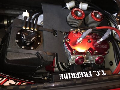

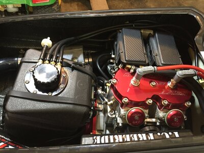

First I replaced the scuppers with ball valves. Then added a bilge pump to the left rear corner of the engine compartment beside the rear tank. It won't pump it dry, but it gets the bulk of the water out fast, the ball valves do the rest. I tried the turf shields under the carbs, they helped, but not enough.
Best thing I did was add the Thrust flame arrestor bases and Yamaha square air box lids. Basically the same as the ones above for sale, (I would buy those in a second). I opened up the air inlet some to make sure they flow enough air.
Our second re-fresh lasted a lot longer than the first because of these mods cutting down on the water getting in the carbs.
