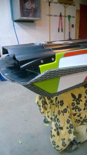

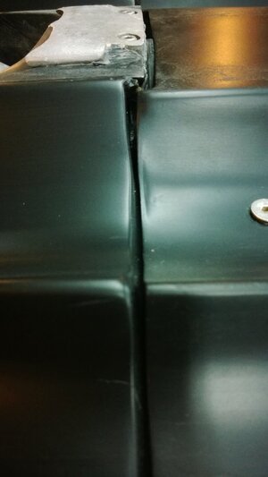

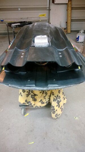

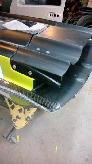

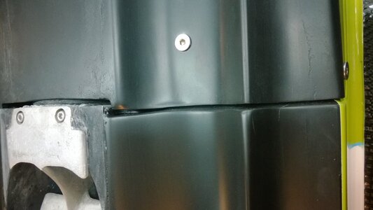

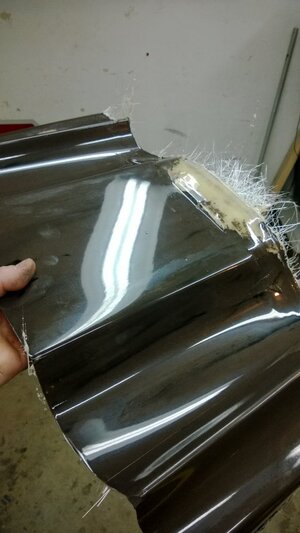

I cleaned the clay out of the mounting holes with a tap, I can understand why some people have a gripe about how some of the plates fit on other skis.  Every step I took made the plate fit different.  had to woller out the holes on the sides a tad to get the bolts started, but it fits good now, still need to test fit the pump and probably have to grind the top of the plate to clear the pump, like the plate was that came on it.  I plan to layup another plate tomorrow that will be the shorter one, anyone have any suggestions on how to locate the holes on the sides once it is all trimmed to fit, I thought about placing this one in the mold and drilling them into the mold, but I think just measureing it out is gonna be a better bet, ecpecially since these holes had to be opened up a bit as it was.
