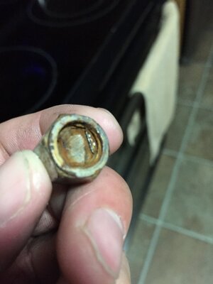

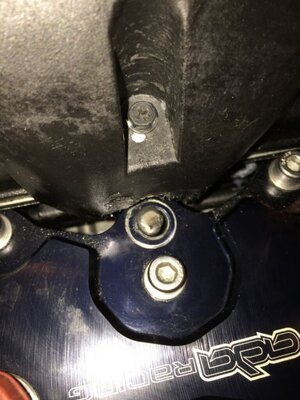

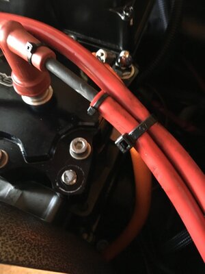

I installed an ADA girdled head on a ski about 13 months ago. He put a ton of fuel through it last season and just texted me today with these pics. Studs where torqued to 30 ft/lbs. Does ADA have any sort of warranty, does anybody sell just one stud assembly?

ADA assembly instructions specify the use of anti-seize and a maximum fastening torque of 23 ft lbs. As you've admitted exceeding the fastening torque by approximately 30% it's probably unreasonable to consider it a warranty issue.

Did it break when trying to remove it or just fell off? It is surprising that it is so rusty especially for freshwater use (Correct?). The acorns and studs on my surf ski have no corrosion at all after several years of saltwater use. (Marine grease on threads and spray corrosion X monthly.)
The 30ft lbs. is not a problem at all, it is our recommended torque. We have torqued many, many and never seen a failure like that before. We have the replacement studs and acorn nuts in stock.

All freshwater, just fell off the owner said, he found it rolling around in the hull. I went through and re-torqued the rest and put a stock cylinder screw in its place temporarily. The broken stud was finger tight in the cases.
I note you mentioned the stud was finger tight in the cases. It's possible the stud had backed out sufficiently to allow a miniscule gap to form between the head and the nut. Resonance from engine operation would possibly allow the stud to fracture just below the nut and allow the corrosion to form over an extended period.
