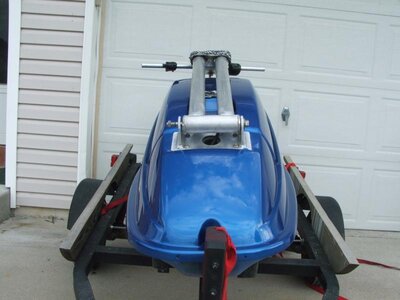

Wow that is one nice pole setup. Have you had the chance to try it out?
I will in about 2 weeks. Highroller and alot of other hardcore freestyle guys use them and say they are the strongest and lightest on the market,
And cheapest. 400 for everything built to ur specs. Mines neg 3 inches

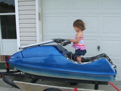

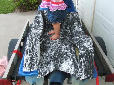

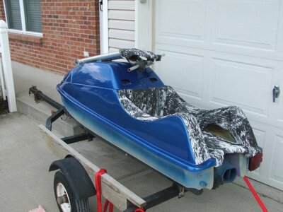

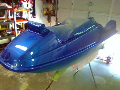

Its final. Paints not done but im riding tomorrow...
Oh and in pic 4 it shows where we f*cked up the turf, but soon the turf will be around the rails to.

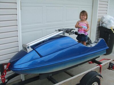

Finally! It looks nice, I like the shaved gas fill. Now I want a goose pole on mine.
Ya i like the goose pole. It's about to be powdercoated.
I think the gas cap filled, the other lines taken out, and the hood changed really make the fx hull flow better.
