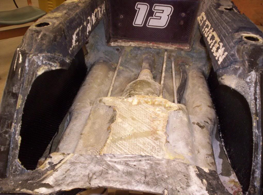

Yup, I'm the same one looking for an SXI Pro hull. It just occured to me, given the knowledge base on this site, that I should have asked this question first. Best I can tell, the cooling water supply line from the pump to the motor has cracked. When I run the ski, it fills the tray and gunnel foam with water. Since the water is trapped in the foam between the hull halves, it doesn't drain so the ski is now VERY heavy. Anyone have some tips on how to cut this open and repair the line. Thanks!!
I would just cut the whole tray out like this.
Then you can fix whatever is broke, refoam and install footholds if you want to as well. Or you could go foamless and just install a drain plug and drain it after every ride. Personal preference really.

so the sogga continues....cut the hull and FULL of H2O, defoamed and found nothing, preasure tested & nothing, See pics. So cut in to sides of tray to look at the rest of the exhaust...... did you know that there are TWO hose clamps on a rubber expansion joint at the end of the silencer to connect the exhaust to the rear port!!!! the freaken things were both loose WTF....So let the reglassing begin, after a water test however. any suggestions on refoaming.....should / not. what should i use if i do?
