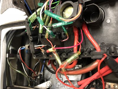

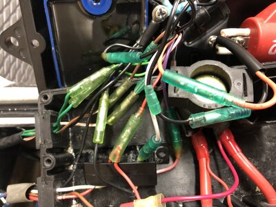

Long story short, after figuring out I had a bad stator and replacing that and the flywheel , I am trying to put my Ebox back together. I had previously disconnected everything trying new cdi etc. to figure out what my problem is. Now when I am connecting my starter relay to the brown and red wires it is powering up and cranking without touching my switch. Would this mean I have an issue with start/stop switch or wires mixed up? This is my first superjet and still trying to figure everything out.
