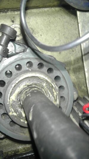

i have a waverunner 701 2 seater that has a leaking driveline its so bad it fills the hull all the way up with water if i let it, the water is flowing in through the bearing you see when u look into the engine compartment. i currently have a bilge in it, but my question is how do i repair this im currently looking up repar kits on watercraftsuperstore any help on how to replace this leaking part would be greatly appreciated thank you.

Sounds like you have a separated midshaft housing which is leaking the water into the hull. Housing can't be repaired. We have them in stock new or used.
