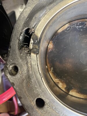

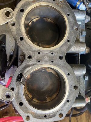

Not to sure what this means but it doesn’t look good.?

Yes, it could be just the Head Gasket.
That's definitely a blown Head Gasket.
Install a new one and read the Compression on both Cylinders again.
But at 115 psi it's time for a Top End Rebuild at the minimum.
If you keep running that Engine, the Piston Skirts can break-off and totally destroy the Engine.

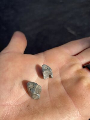

So while I was cleaning off the head and removing the old gasket I noticed These two pieces which I assume used to be one piece floating around in the inner chamber between the two cylinders. Do you know what it is and if it’s worth replacing? There are old thread marks on the innards of them and I’m assuming it went on the little Phillips in the center.?
it’s a anode, helps keep corrosion at bay, yes it goes there. Some people run them and most toss them or never replace them.
