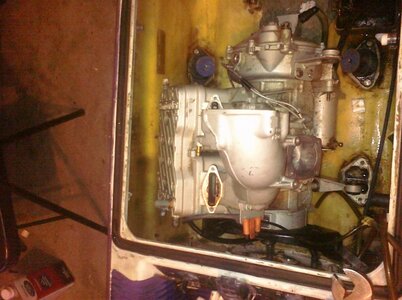

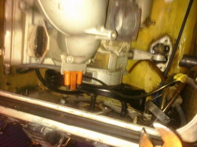

I have the old square thats gonna get some love this winter and for grins I thought I would just drop the 787 to see how it fit. The shaft is about an inch too high... I guess you could get around it if you were dead set on doing it but it seems this motor weighs soooo much for 110 hp there are better 110 hp options that would be more viable. This motor is fuel injected which would be cool but wouldn't be worth the time invested I don't think. It is cool how far back the motor is though. This motor was in an old gtx we had till it caught fire.
With the amount of room from the motor being tilted it appeared the stock exhaust should go where the yami exhaust exits the back.
