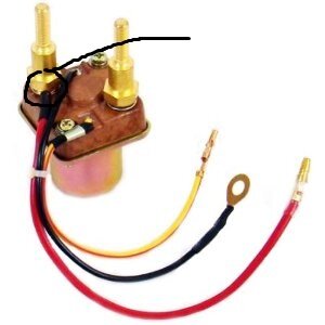

Hi, I know this subject has been covered pretty good for this ski, but I am still having a starting problem, or lack there of. I have a 95 Kaw 750 sx, It's been pretty hard to get it to start since I bought it last yr. I finally figured out that it is a lack of spark. It only has a spark when letting off the start switch, Never while just cranking it over. The things I have replaced. Coil, Rectifier, Relay, and I tried a used CDI that was supposedly working just fine on the ski it came out of. The only thing I have not tried or replaced is the Stator. If I am missing something Please Help. I also was told to maybe check or replace my starter?
