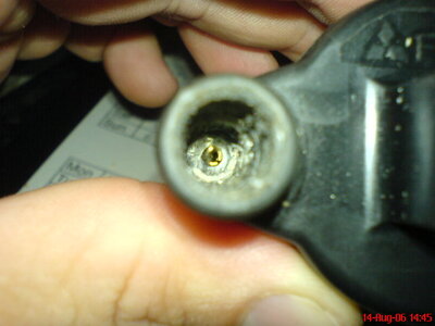

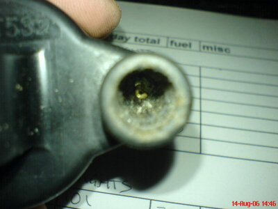

i had an intermitent spark problem this weekend so decided to fit new leads from jss
and i thought some of you might want to have a look inside at the brass pin if you ever decide to do it
i used i small flat head screw driver and worked my way around the old lead braking all the epoxy then give it a good tug and it came free i might of been lucky:biggthumpup:
