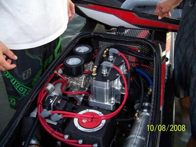

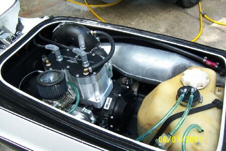

1st attachment is the 900cc (862cc) engine.
2nd attachment is the 1000cc (992cc) engine.
