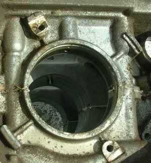

Timing must line up, check the flywheel, they are known to spin at the keyway. If you need specs on the stator, I can look it up by year. If the CDI is dead, I have not had luck testing them, I usually swap with another good one . The mark above the stator mount hole is the timing point, there should be a similar one on the stator plate. Crab

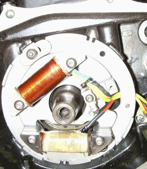

meatball I have heard mention of a CDI in a Kawi before but I only see a voltage regulator, starter relay, and coil....I see the mark on the upper crankcase half however I do not see one on the stator because the outer lip of the stator mount points are broken, the stator is held in by two screws and oval plates that fit into the stator mount points.......does that make any sense?
pic
ok.....what's wrong with this picture........:sneaky: :banghead: :sneaky: :banghead:
