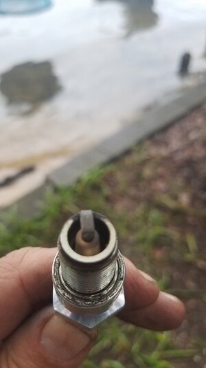

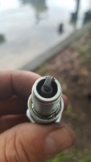

No compressor near the water but I blew through the line and had air coming out and it didn't take much force to blow (insert joke). Attached are some pics of the plugs. Looks like one is lean to me, what do you think? Looks like I have some carb adjusting reading to do. I have no idea where to adjust.

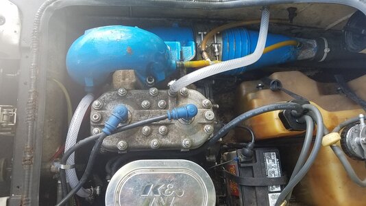

Here is the cooling set up. I tried to plug off one line and run from the pump to the motor, then to the exhaust like I've read but it just made it steam quicker since the heat is coming from the motor by the time it got to the exhaust side it was already steam.
looks like I really need to go back through the cooling lines like you said. Where I'm confused is i have 3 lines off my pump. Looking from the back to the front of the ski i have 2 on the right. One is the siphon drain. The other one currently goes to the top of the header. It seems like there is good water flow to this one.
On the left of the pump it has a fitting on the pump, a hose comes off toward the back and does a U bend back into the ski. From here it goes to the bottom off the header then out to the top of the head and out. This is where my over heating is. I pulled the line off where it enters the engine compartment and ran the motor. Barely any water comes out from the pump but it does not seem to be clogged.
I don't get the two lines off the pump, one on the right has good flow, one on the left has poor flow.

The 2 lines on the right are the stock cooling and the stock siphon.
The line on the left is an added line for dual / parallel cooling.
The thing about that, is that the hull only has 2 through-hull fittings. The 3rd tube has a fitting on the inside but not the outside. That 3rd one with no fitting on the outside is an outlet for the stock exhaust. It was never intended to be a cooling line. I have seen where people turn it into a cooling line by pushing another tube into it, but that would be extremely restrictive. If this has been done on your ski, it could explain a few things.
For dual / parallel cooling, you want an electric bilge pump so you can remove the stock siphon. You should then run both cooling lines from the pump to the motor and cap that 3rd tube that doesn't have a fitting outside of the ski.
If you are wondering which fittings on your pump are which. The cooling lines are 90* into the pump. The siphon line points backwards and is connected to the reduction nozzle.
You ski shouldn't need dual cooling anyway. You can run a single cooling setup.
If you do run dual cooling, you can follow the B-pipe diagrams online if you have 2 fittings on your pump, your exhaust manifold and your head.
For parallel cooling, You still need 2 lines on the pump but only one on the manifold and the head.
