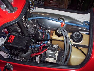

B pipe, carb, the plugs burn clean at 1 turn on the main, or I can get them dark at 1.5 turns. I don't think its ported, but never had it apart to check, it screams with this setup.
