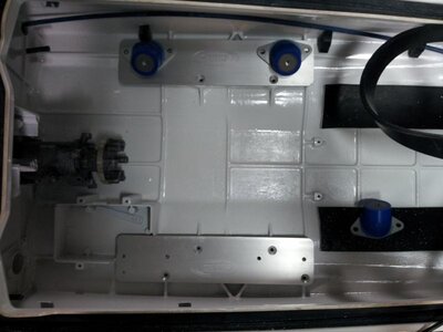

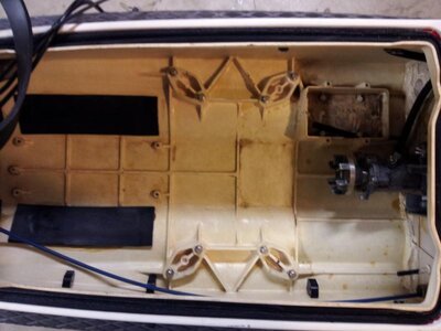

Upgrading to 701 Power

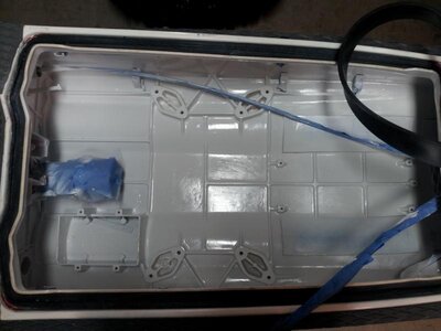

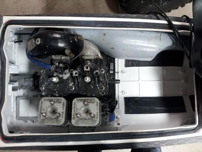

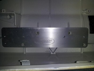

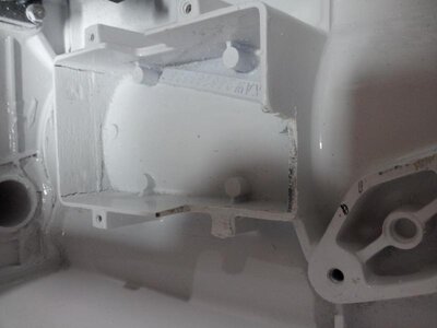

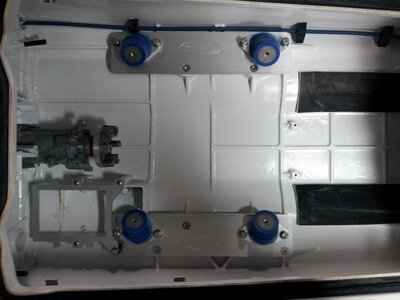

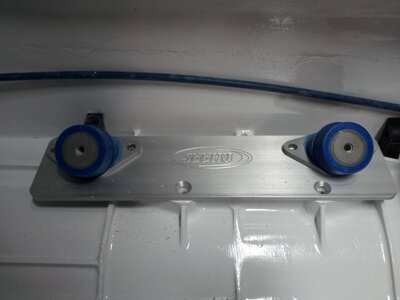

Finally got back around to the 550 that's been sitting for so long. I ordered up the conversion kit from Rhaas to drop a 701 in the 550 hull. The kit was great quality and a breeze to install. Basically All that I had to do was cut the batter box as the instructions show to allow the conversion plates to sit where they need to and bolt everything in. Before I installed the kit I cleaned the engine bay and painted it with appliance epoxy paint. It looks like I'll be able to squeeze a b pipe in there as well!
Any recommendations for a pump/prop set up? Right now I am going to be running the stock pump but hopefully in the future swap that out with something a whole lot bigger. What did the old race skis use for pumps?

Just a quick update: I finally got around to setting up the TL for my SJ so I was able to use the flywheel and ebox from it. I bought a starter, bendix and flywheel cover so I was able to get those installed. Now all I need to do is hook up the start /top switch, shim the engine (get engine bolts), figure out a water box and put a gas tank in.
