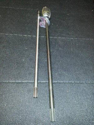

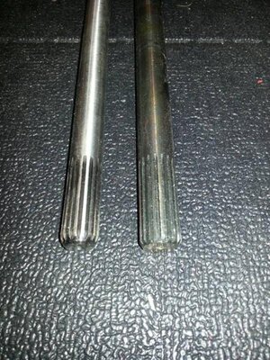

Shaft is just over 30" so somewhere around 4" longer than Superjet.
Here its is here against a Superjet Setback shaft.
