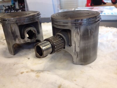

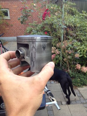

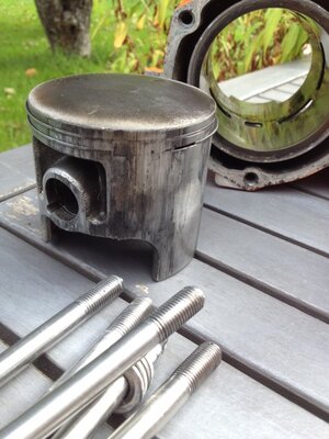

Hi Guys,
A good friend of mine, is racing a '12 SJ, its a limited setup. This machine, has sized around 10 pistons.
First of, he bought the ski, with very little use. He put on a b pipe and a hooker 9/15. nothing else.
This sized the first piston.
After this, he tried almost everything to keep the engine running without seizing again.
Msd Enhancer cdi with RPM limit from 7500-8000rpm
ADA head with domes ranging from 150 - 180 psi.
stock dual 38 carbs with 150H and 75L jets (AM air filters) with external fuel pump.
Water routing is single cooling, starting in B pipe manifold, head to bottom of head pipe, top of head pipe to T, running in to stinger and overboard pisser. (we are in cold water in Denmark, our water temp at the moment is 15deg Celcious) and the last pistons sizure happened this weekend in training for Danish championship. He is running 95 octane pump gas and have tried 4 types of oil, currently running Castrol Power 1 fully synthetic.
There is no pattern in when or why the seizing happens, sometimes its the front cylinder, sometimes its the rear.
This is obvious really frustrating and a bit expensive, he is riding the ski pretty hard on the track and most of the time he is WOT.
It has also sized pistons in another cylinder, that was "flowed" no change to port timing.
We really hope you guys, who are racing limited Superjets, can help us or just some really sharp mechanics.
