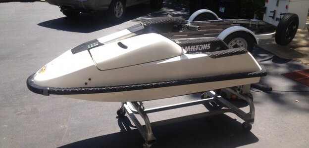

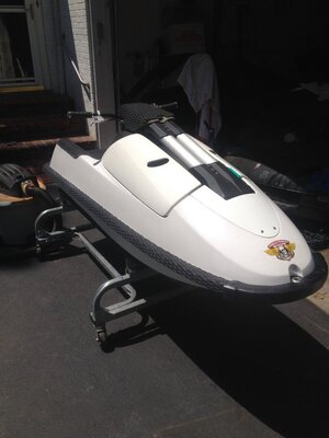

Picked up this ski a few months ago and have been rebuilding little things ever since.
New steering cable
New midshaft housing
New midshaft
New couplers
New pump bearings
New midshaft bearings
Xmetal waterbox
New clamps everywhere
New water lines
New fuel lines and filters
New exhaust gaskets due to leaking
85mm bored reduction nozzle
Xmetal hood catches, modified rrp bracket
Cold fusion hood hooks
Hood straps
Jetmaniac lightened flywheel
WDK steering system
New Toby made d-cut ride plate
2 new motor mounts

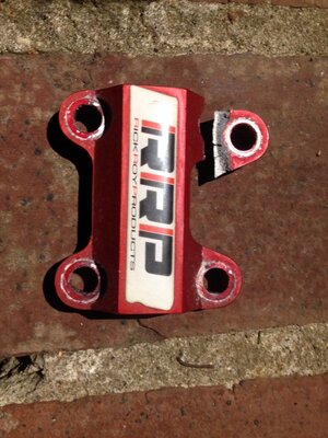

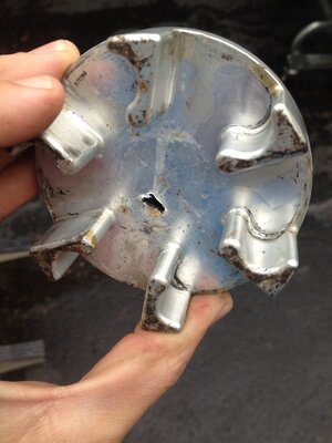

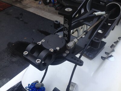

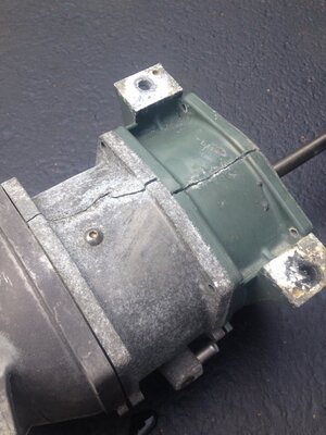

Salt water seemed to the culprit in a lot of the repairs. Swelled the mag pump which is still out being repaired. The rrp fat bar steering had to be replaced bc the top clamp had a broken ear. No one sold just the clamp?! All hose clamps has some for of rust and some just broke as I was taking them off. Salt water sucks!

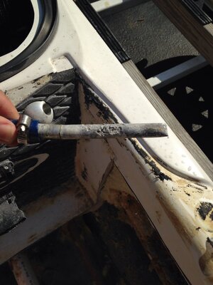

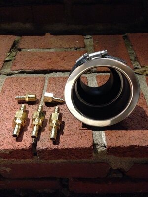

Found that the midshaft side coupler was pitted on the inside. So pitted that I poked a screwdriver right through the center. Another order for Jetmaniac.

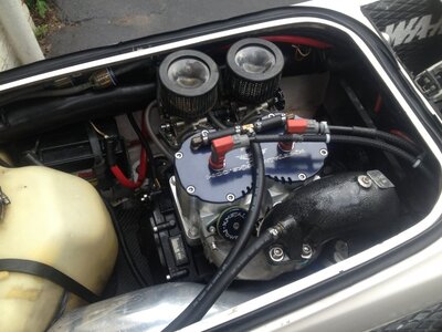

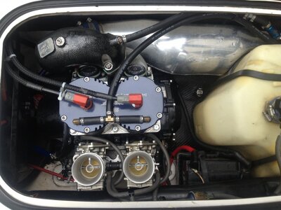

Motor specs:
SS827 cc xscream PV cylinder. Pump gas
49 mm full spec carbs
Boyesen rad valves and intake
B-pipe and head pipe bored to 48mm
MSD enhancer
Lightened 61x flywheel
Pump:
Oem
C75 swirl 14/19 (I think, reworked)
Stock cone

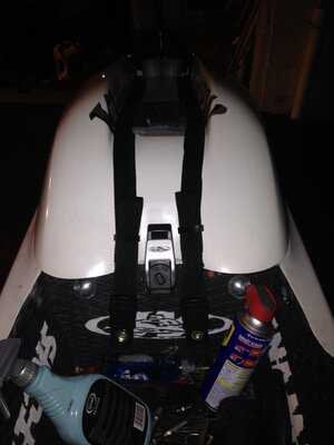

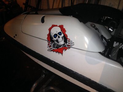

New decals and hitching a ride on the speed boat

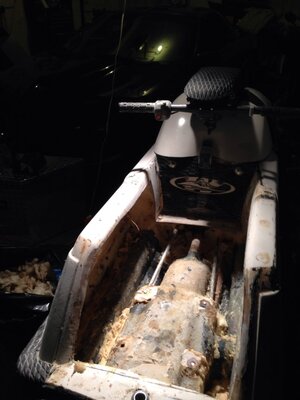

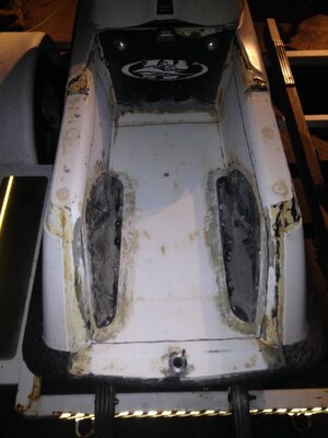

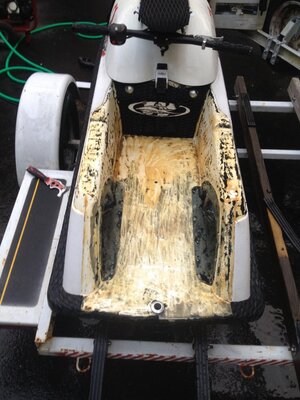

Already time to Defoam. While riding the other day the tray began to swell up like a ballon. Possibly busted water line in the hull. Then the boat started listing hard to one side. Drilled a hole in the tray and pumped in compressed air. Cracks on both footholds and air coming out of a water line.
I guess salt water corroded the water lines as well. Over time and with high pressure water going through the tube it must have sprung a leak.

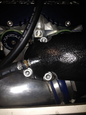

All three b-pipe bolts stripped out of the manifold. The bolts that were originally in there were a little too short. Maybe 5-7 threads had a grip. Ordered new longer bolts from Jetmaniac and installed 20mm stainless time serts. Fixed!

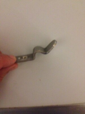

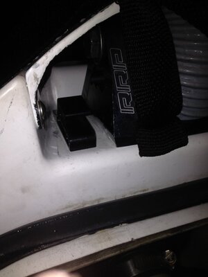

image.jpg image.jpg image.jpg Had to modify the rrp bracket to accept the xscream hood hooks. Added 2 more fastening points to the bracket and removed the flimsy oem metal hood hooks. I did this mod after the hood hooks bent on a 3/4 roll off a wave. Also bent the hood side hooks as well so replaced those with cold fusion hooks. Added hood straps as a safety net.
