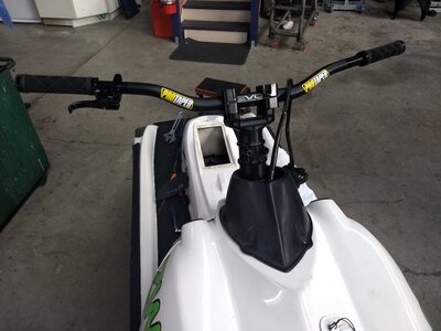

New steering tower (taller), bars, grips, throttle etc

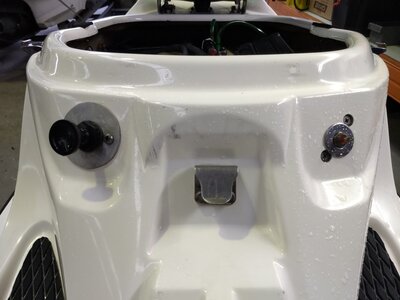

Get some wattholes installed for the bilge switch and primer
Install a second bilge under the seat where the water actually sits

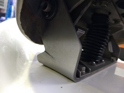

Get the hinge welded and some sort of gas struts or reinforcement.

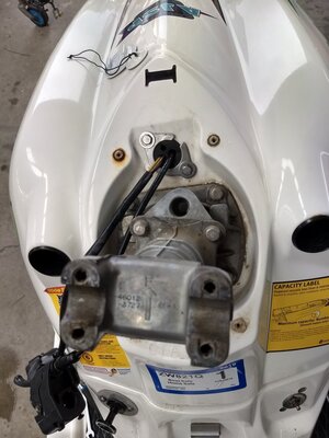

IMG_20180418_074109150.jpgIMG_20180418_074210348.jpgIMG_20180418_074250558.jpgIMG_20180418_074306438.jpgIMG_20180418_074352453.jpgIMG_20180418_084048564.jpg
What started this tear down now instead of later on ^^^

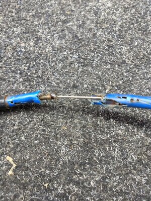

After getting the steering cable out me and my old man started ringing around various boat suppliers trying to find a generic cable instead of the pricey OEM cable. Everyone had the correct length cable (just shy of 9ft or 2.7 meters), but they all had the wrong amount of throw (3 inches as opposed to 4) or an imperial threaded end. It turned out to be a real pain to find a cable, and with these models being almost non-existent here we couldn't get a second hand cable from the local wreckers, or several dealerships/indie shops. We are still trying to get onto a new cable at the moment, just waiting for some return phone calls and prices.
I've tried to write up the process as best as I can that we used to make this cable but I missed out on seeing a lot of it, but it was really good to see how a cable goes together.
In the end we were able to make our own cable out of two cables. I wish that I was watching pops when he started this, but I was a bit late to the party and only helped him crimp it on and trim the outer to the correct length. We settled on making it about 9ft total length. He had cut apart an older SXI cable that had some tears on one end. We used the outer from this, after carefully measuring the length of the original cables inner and the amount of throw. I missed watching him machine the various ends to make it all fit. We cleaned out the outer cables inner sleeve several times with brake cleaner (god bless brake cleaner) and lubricated it with fogging oil. The next step was to slide in the cable in with one end on it. This was greased very thoroughly as it went in. We put the metal outers on the other end of the cable, and used a hydraulic crimper and die and crimped the threaded rod ( that was drilled out previously) on the inner cable to approx 10 tonnes. I hope this cable holds out. Sadly I didn't get any pictures of this process.

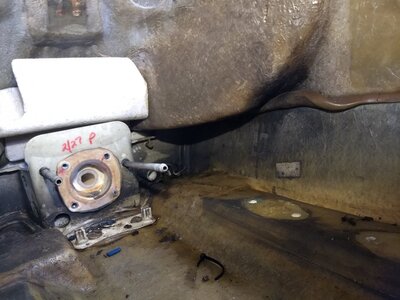

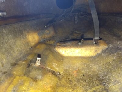

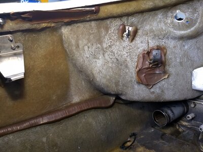

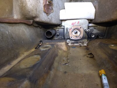

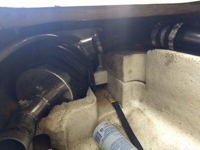

These are just some various reference photos in case anyone every wonders what the inside of the hull looks like completely stripped out. It seems almost identical to an sxr. You can sort of see the spot where the battery would sit in a sxr, its near the exhaust tube. I cleaned the hull a couple times and its come up a lot cleaner. I had some luck with this ski taking it apart. I knew it had TBM sponsons, intake grate and ride plate, but on further inspection it also has a "TBM super pump cone. I am still not 100% sure on what the prop is, but the ski absolutely hauls ass so it must be pretty good. Also during the tear down of the motor I discovered it had a TBM LW Charging flywheel. Score!! It looks like at some point a starter clutch or flywheel grenaded in the front cover. Plenty of metal flakes and dust in there. And to top it all off it had a TDR waterbox, but unfortunately it looks like at some point in time it ran super hot and melted alot of the foam at the front of the ski. Does anyone know if this foam is unique to the G2 or is it the same as and sxr.IMG_20180419_130630471.jpg
Looking up at the nose
Looking back from where the fuel tank sits
Carby side
Exhaust side
Had to heat it up a bit, the shaft was fairly rusty

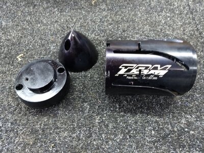

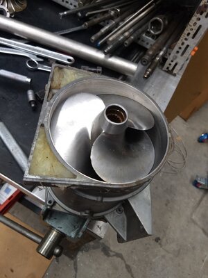

Photos are of the prop before and after sand blasting, and a light polish. You can see the belt sander marks where it was ground down a bit. The last photo is crank after washing and oiling. There is some very light rust on it still I haven't wiped off. All the bearings spin great, rods feel good and the keyway looks good. too.

Exaust hose did it only have the one bracket on the hull and just one big long hose or did it have some metal pipe fittings with bends on the right side of the hull ?

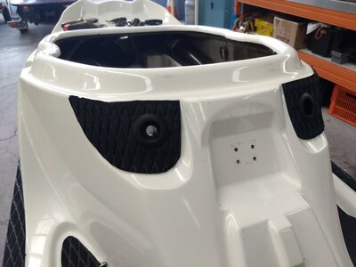

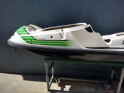

Hunkered down on Friday and got some good work done that I had been putting off. I turfed the rails as the stick on bumpers were coming off and I don't really like the OEM bumpers, and they also cost a lot of money. I think turf looks better anyway. I also "drilled" out the fuel tap and choke holes to accept wattholes and turfed that area over. I think it came out pretty mint. I sanded the edge of the turf with a pistol grip air sander (forgot to get a pic of this afterwards).
It seems to provide the best looking and smoothest finish over a razor blade or scissors. I also got the water box in and the exhaust hose.

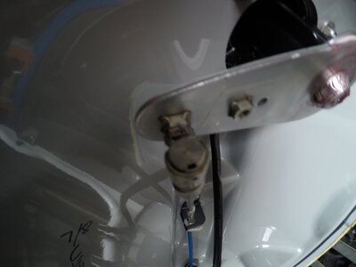

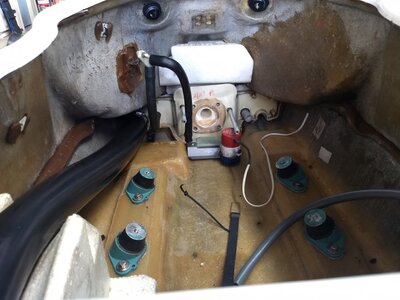

Is there a lot of stress cracks in the pump area in the top ? The picture is of my ski just curious...
Looks like the tube on the left hand bottom of inside is for the steering cable and the arch bulkhead plastic area is where the battery cables go through to the battery ?

Good news for you. Next week I'll be doing a detailed post on how the hinge goes together and how it attaches to the hood etc. I took it apart to get those tears welded and then decided to go with powder-coat as well. I checked against the microfiche for that throttle cable and it is the same for an SXR apparently. I'll post up a pic when the hood is back on. I'll have an sxr to reference by the time all my parts arrive. Genuine crank seals won't be in until next month unfortunately, but I can always ride my other ski ( I attached a pic) so no big deal.

There seems to be a severe lack of info on these skis compared to gen 1 x2's.IMG_20171222_131502226_HDR[1].jpg
I also rang a local Kawi dealer and he was kind enough to tell me that this ski originally came from Western Australia. I live in Brisbane and bought it from Victoria. This ski has been everywhere, man.
I pretty much posted all my questions... I also cross reffranced the throttle cable on microphish but was just curious how they routed it on a gen2... Theres a huge lack of info here in the U.S. where they didint even get sold

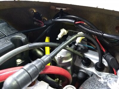

here's the last mock up picture I took when finalized my wires and fuel lines... The next time I put the motor in its staying in
And a pic of my other ski as well

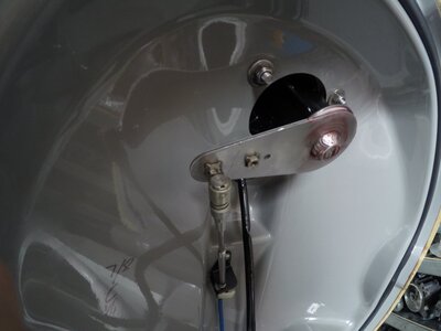

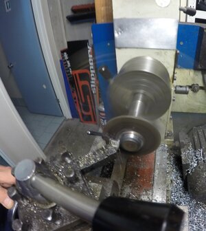

In the meantime after a whole lot of drama with the steering shaft (had to get the lathe and a welder involved), I finally got the steering tower on and it looks super tough. I think together with the turf on the rails it looks much more modern/updated.

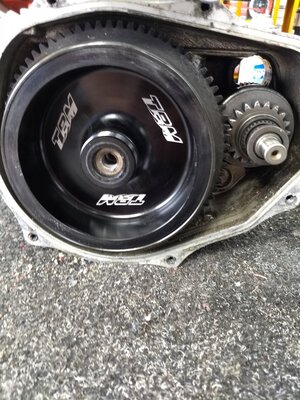

Put the bottom end back together

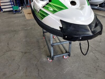

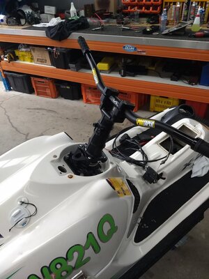

Sourced some Yamaha stainless Ball sockets + ball post for both ends, along with the new RRP steering nut strengthener
In relation to the new steering tower shaft I had welded, the captive nut was on the wrong side, luckily the new Yamaha style ball posts I got are long enough to go all the way through the nut and out the back for a nylock nut, and this is the same for the steering nozzle.
Hinge, Hood, and steering tower on
Information I have learned:
Steering cable is totally unique to ski as far as I can find. Part Number: 59406-3782. It is approximately 9ft/2.7m long and has around 4 inches of travel.
The throttle cable is the same as any SXR. I have not checked if this is the cable that is in my ski but I will need a new one anyway. Might end up using a couch cable or something. Will have to see what is laying around.
The S/S harness is probably also the same as an SXR. You could use any kawi switch really as long as it was long enough.
Steering tower:
The steering tower shares several components with other couch skis. The bushes can be used, as can the stopper bit, the castle nut and any steering tower/post. I went with the stx post because its the tallest and I'm pretty tall and would like to be a bit more comfortable.
The shaft and arm are also unique to this ski. The square part on the top of the post is indexed to the ball differently to couch shafts. This means that if you use the incorrect shaft with this cable and system, it may have insufficient throw, or turn more one way than the other etc. I had some difficulty removing my shaft as the salt usually packs in between the two square parts of the post/stopper and make its difficult to take apart. I had to use a big ass brass hammer to smash it out, and ended up peening the top of the shaft over so much the castle nut wouldn't thread back on, and a tap would not correct this.
This led to a huge debacle to make up a new one. We successfully unpicked the weld using a lathe. Generally if you stand near a lathe long enough something usually turns up ;).
We matched up the shafts on the bench and tried to get the indexing as close as possible (the square part of the shaft in relation to the ball post) using a straight edge. It was then tacked with our MIG. Initially we tried the weld ourselves but had trouble keeping the arm parallel with the bush. It would probably accelerate wear on the bushes and even break. So we caved, re picked the welds, re tacked and dropped it to a local stainless shop and they laid down some sweet as welds on it. Also did up a spare as well.
I like these particular Yamaha ones as the outer part is indexed to the inner part so it doesn't slide around itself and is easier to put on when you can't see what you are doing.
Overall it was a bit of a struggle to get it together with all the little mishaps, however it turned out really good and the steering feels good with the new bushes, grease, cable and ball sockets/posts. The next post will be about the hinge.
I think the ski looks really tough now with all the black steering bits.
