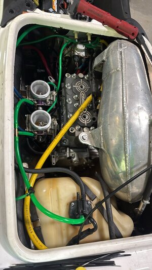

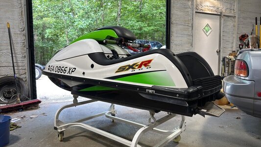

Recently I picked this up after posting a WTB on FBM. It was local, belonged to a guy who passed of brain cancer and then it sat. It went through a shop to get running again, as it lost spark. They put all new stock CDI/Stator on it, spark came back, but it was back firing through the intake manifold.
Enter me. I was set to buy an 1100 SXR from the person who was selling this, but elected to buy this for a number of reasons:

Popped the hood and found this. Factory dry pipe, Novi 48's, R&D 29mm head. Coupled with the Temest 3 ingition (removed, but have still and TL FW) this thing would be an absolute ripper.
Pulled the carbs off, gave them a cleaning inside and drained the fuel and ran new lines. (Kawi green for power and air bubble spotting)
Sick, cleaned a bunch of poop out, figured we're good to go. Wrong. Hit the start button, coughed for a second, got some smoke out of it and then started the intake back fires.
