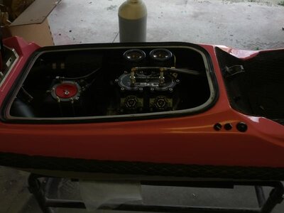

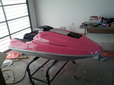

IMG_20130408_135821.jpgIMG_20130415_154326.jpgfigured I'd post up my build since I got to start it yesterday
Hulls a carbo Wdk rev weight is 76#'s bare without the hood. Motor is a Php 898 nikisal. Pfp dasa intake with vf2 reeds. ATP epic is handling the ignition duties and I'm running an OEM 155mm pump waiting on my prop from Php witch I believe is a scat 8/19 thin blade.
Shake down run went fairly well today. I was only in the water for about 10 minutes. Looks like everything has held together minus my throttle cable bracket. All fixed and ready to head out for wave daze.
Figured I would post a complete parts list.
Wdk rev carbon
Nikasil plated Php 4mm 898
Cold fusion motor mounts
Dasa intake manifold vf2 reeds
Novi 48's
Pfp with pf water box
Raider 62t mid shaft housing
Ada mid shaft
615 free ride couplers with OEM kawi dampener
Prok flame arresters Blowsion outerwear
Jazz tank and cold fusion fuel filters
Jet maniac steering and throttle cables
ATP epic and jss coils in raider ebox
Billet ATP pole with ATP mini steering system
Rrp riser far bars with odi lock ons Blowsion finger lever
Rrp light weight pole bolt
Oem 155mm pump
Rad dudes efi battery cables
Deka ext9
Scat 7/18 thin blade prop
OEM starter starter solenoid and flywheel
All fastners through out the hull are ss Allen head minus the pump
