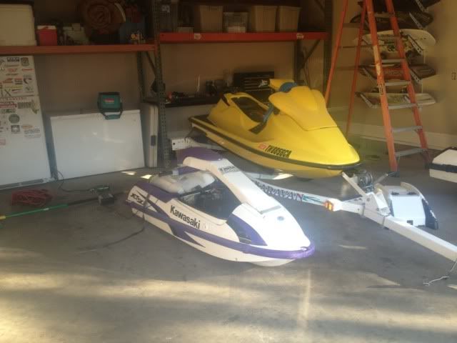

Decided I would make a thread on here for some advice on my rebuild/refresh of my 1996 xp. So far I have pulled the motor out and waiting to hear back from some people about getting a hook up on engine parts. My goal with this ski is to make it reliable like the original engine was but with some more power, also plan on addressing any issues and update it some. I mainly use this ski for just jumping wakes and playing around when I don't have a stand up to ride, I love this hull. Its a really clean original ski for a 1996 and I plan to keep the looks slightly original with some updating from its current banana state.
Mods it has
- Factory spec II pipe
- Microtouch SD rev limiter
- water injection
- jetted carbs and flame arrestors
- deep intake grate
- impeller with a ton of low end
Plans
- jet trim seat
- hot rod crank and full engine rebuild
- TDR water box
- single gauge hood
- umi steering
- some kind of sponsons and trim tabs
- maybe a higher compression head but I want to run pump gas, not 110
