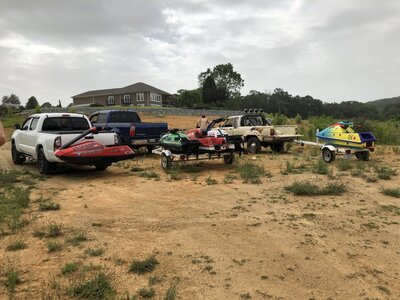

Glad to have finally rode with Brappadoodle! He came up to our pond yesterday to ride with Hornedogg and myself.Great day on the water too.And Brappy got his ski close to being dialed in! l know how frustrating it is to get a ski after a complete rebuild where you want it.Pain in the ass,frankly.
But your ski runs great and you did an awesome job on the build man! First SN l have rode in a long time and it had power.You will have to come back and ride again.
Can you tell we like Toyota trucks
Yesterday was a lot of firsts for me,
First time I have ever driven 30ft under a lake to launch my ski
First time I've ever seen a Wet-Bike
First time riding with @Sanoman after hanging out and working on skis for an entire year! also first time riding with @hornedogg79 for that matter
First time I've ever ridden an aftermarket ski, Like riding a shopping cart backwards down a hill... with power.
First time I've ever seen anyone do a backflip, damn that's crazy in person!
First time I almost took a man out, trying to stay on my ski haha
Also could have been my first time riding a 550 and FX1, but I decided I had enough excitement for that day.
Of course the first time really riding my "New" Superjet and boy did I miss it.

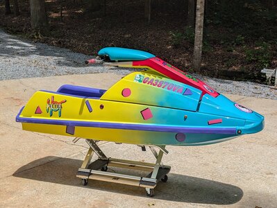

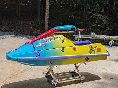

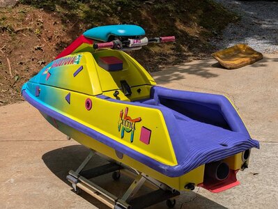

Wanted to bump this thread for a while.... But frankly never felt I had done anything worthy of it... Until now!
For anyone whose never heard my origin story. I was doing 2T couches for a while, getting bored of it, the projects and big engine swaps were getting out of hand for the 20 seconds of enjoyment they give. Wanted a standup.. all I had ever ridden was a terrifying SXR800 up until this point. Not knowing anything about standups, xH2o, bpipeu??
Found this ski on Craigslist.. knew it was what I wanted @brapperdoodle advertised it as needing and engine and some misc pieces. He wasn't lying.
Going into it having never seen this thread or anything of the sort.. had zero/low expectations particularly when you stumbling upon someone else's project the mental bar is always pretty low. Needless to say I was surprised to stumble into such a passion filled piece.
The next day was my birthday, so I decided to spend that whole afternoon, evening, morning, afternoon so I could ride the thing with my old B1 61x. 1 night build basically, I even met @Jr. that morning as I got directed to him in my Facebook plead for an exhaust gasket and saved the operation.
The rest is history. It's been a year and some change, probably 100 or so hours of run time, many friends first's, and lots and lots of learning. It's progressively been upgraded as times gone on. Pipe, impeller, waterbox, zeel, 46 you name it we got it short of pulling that motor and porting&punching it out.
Until now.

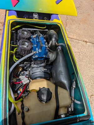

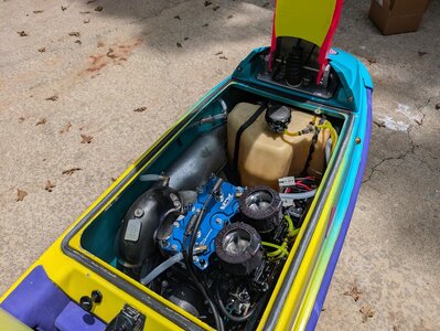

In both the interest of saving some coin & having fun all summer long. Decided to put my LPW 760 Shredder I built for my Vision in this... Maybe it'll stay.. maybe that'll change.... I digress.
I've been forward and back through this thread numerous times, there's some fun comments on it never going to be ridden.... and it's funny to me @brapperdoodle sure can ride, and frankly I'm quite happy with my progress as a rider. This things been ridden just as much as it looks good.. and well like anything neon sitting in the sun. The hours were starting to show. Maybe not to the average admirer, but I look in this thread and my garage I'm looking at a different ski. The rush assembly from me was never something I was truly proud of, there was a ton of stuff I really wanted to clean up.
So it was time...

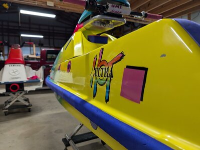

Over the past few weeks it got a new motor, lots and lots of cleanup work in the hull, and well I wetsanded the entire thing...
Super nerve-wracking process, I have done numerous cars, skis, bikes you name it over the years. I do not recommend you try this at home. it's taken me years and years of mistakes to only make a few on this.
Went down to 800grit on all the exposed surfaces, single steps back up to 2000, meguiars M110 & M210 and well, probably 20+ hours later the results are staggering and something I'm super proud of.
It'll never not be brapp's old ski... but much more proud of it with some elbow grease not only riding it, but making it the best it can be. I might go blind riding it when the sun shines just right.
