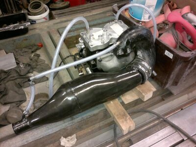

Left image - Engine assembled and ready to go to the ski. Refurbished GP760 engine (new internals), Greater head, carbon tech reeds and factory b-pipe.

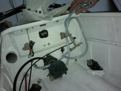

Middle - Engine flush valve so the ski can be fed cooling water when running it on ground. It also serves as a engine flushing kit in case I go riding in saltwater.
