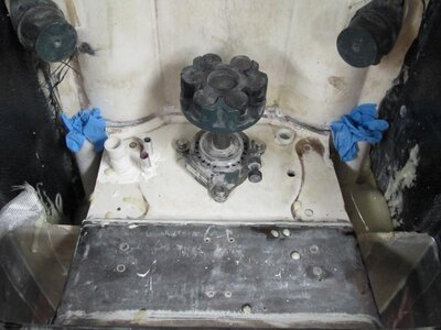

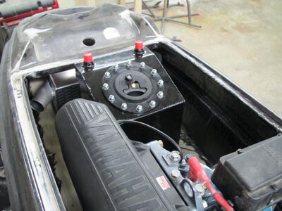

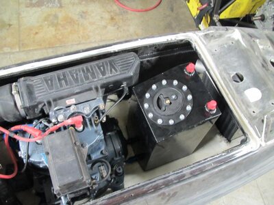

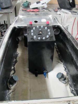

Tank fits with half an inch to spare! Hahaha super lucky...

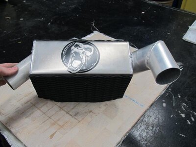

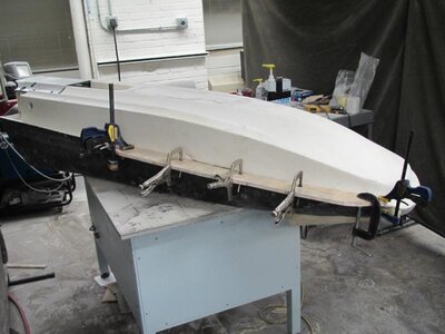

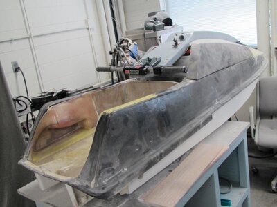

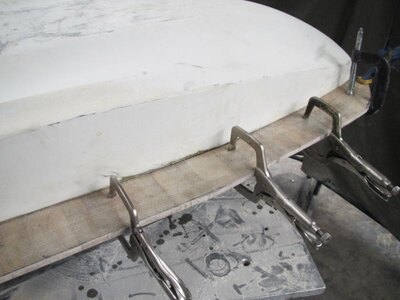

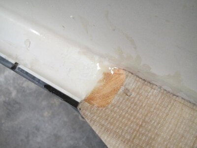

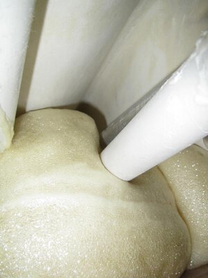

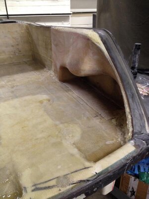

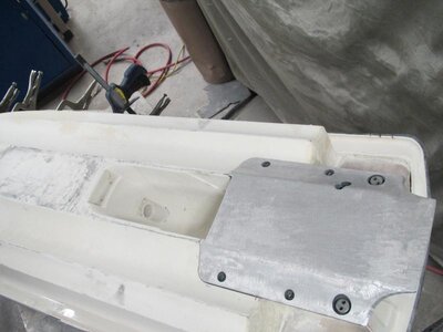

Well... Here are some updates. I foamed the bottom up, got the base of the tray laid, and received my new waterbox. Can't wait to here this cat purrrrr...

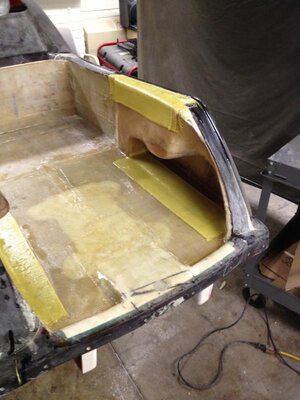

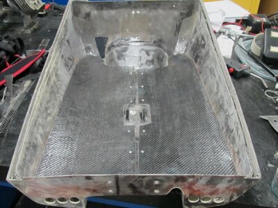

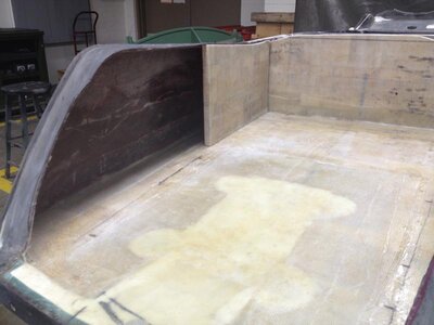

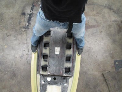

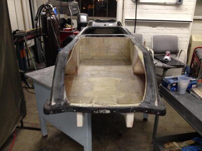

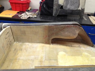

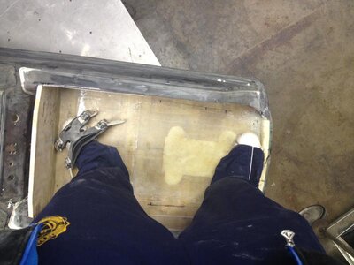

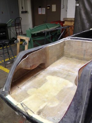

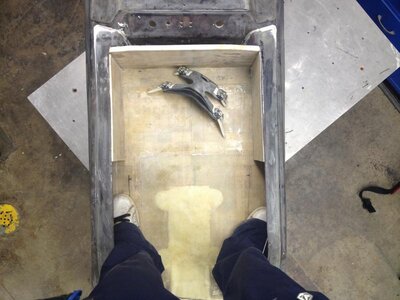

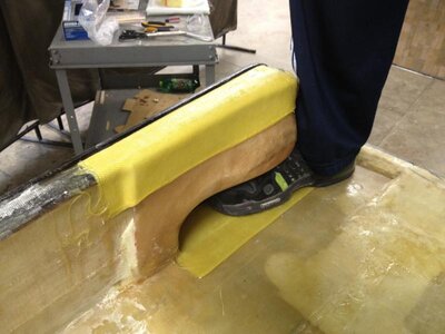

Updates:
Big Tray, footstrap mock-up... Getting pretty excited at this point.

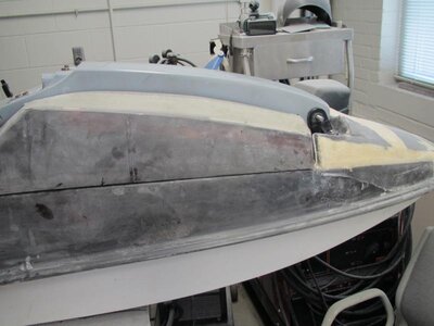

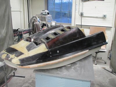

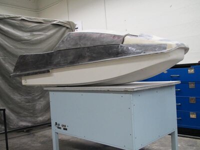

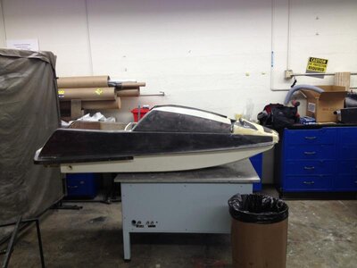

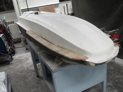

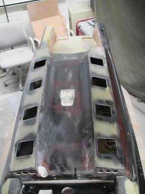

Top of hood is finally how I want it to look.

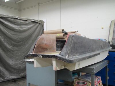

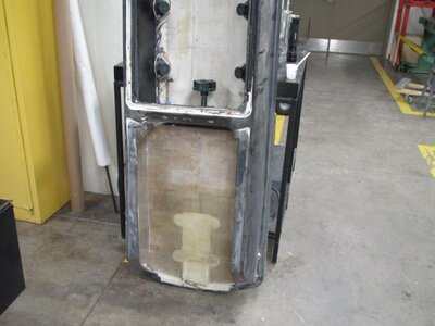

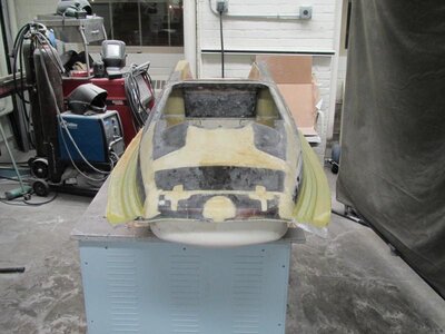

Nose half completed.

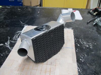

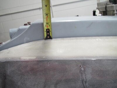

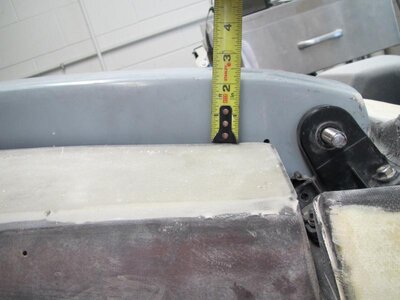

I really like that gas tank. do you have a link to it?
nice work on the rest of the ski btw
EDIT: I found the link http://www.jegs.com/p/JEGS-Performance-Products/JEGS-Aluminum-Fuel-Cells/749961/10002/-1
Yea, be aware that this specific tank barely clears my hood (less than an inch), and the nub that is nearest to the flywheel cover is required to be ground-out for placement. Basically it fits all around within an inch (which is extremely lucky because I bought it on a whim).

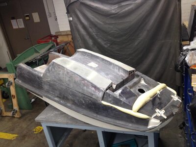

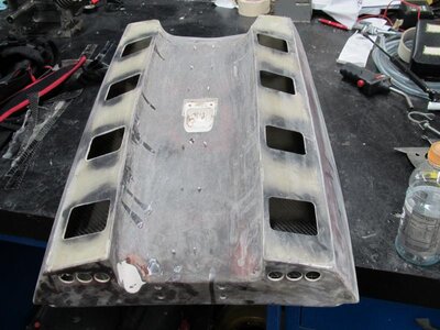

More Updates:
JGringo
When in doubt, Throttle-out.

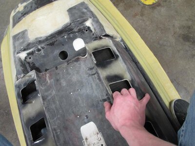

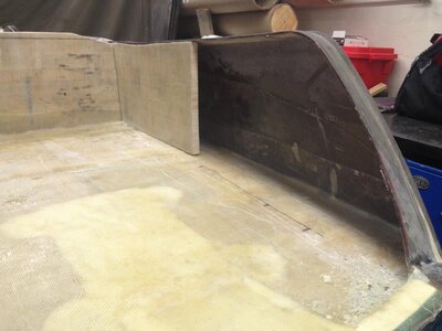

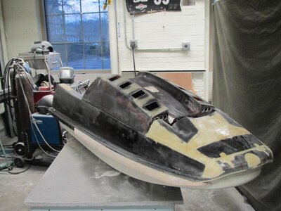

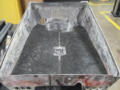

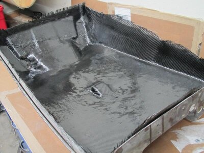

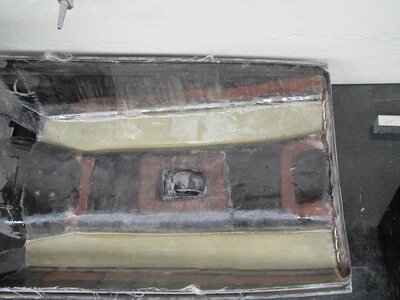

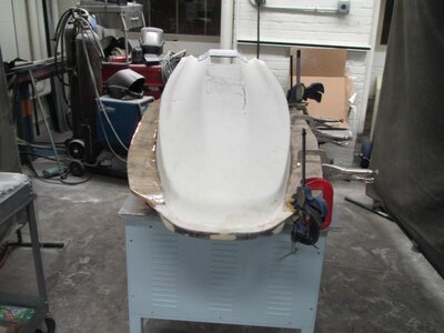

What do you guys think so far? Here is the hood, just beginning to glass the liner in tonight...
JGringo

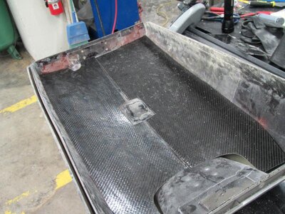

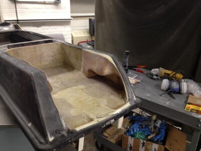

Hood Liner installed:

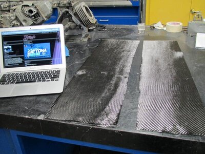

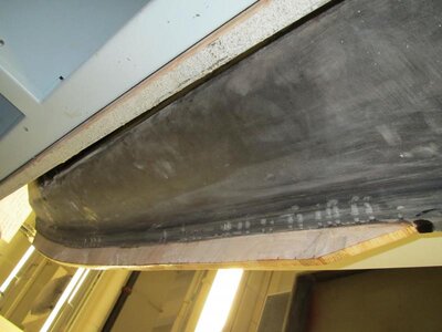

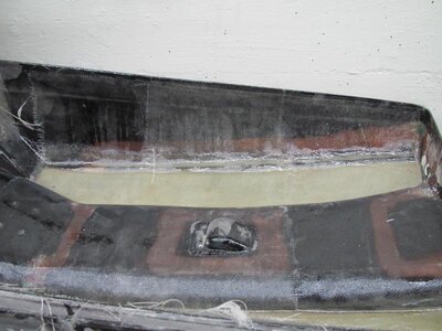

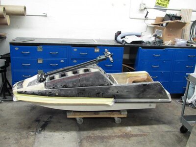

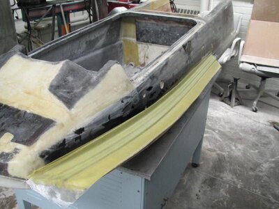

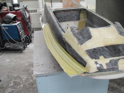

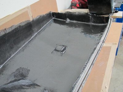

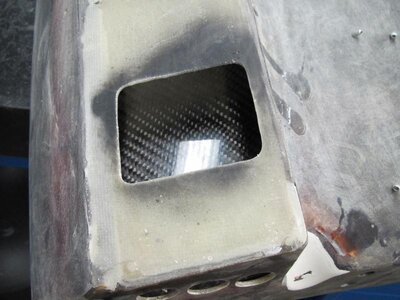

Two kevlar, two glass (8 oz Twill) on 1.5 inch extended rails:
JGringo

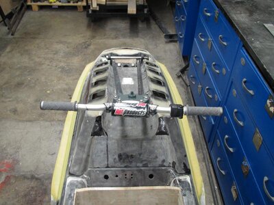

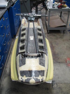

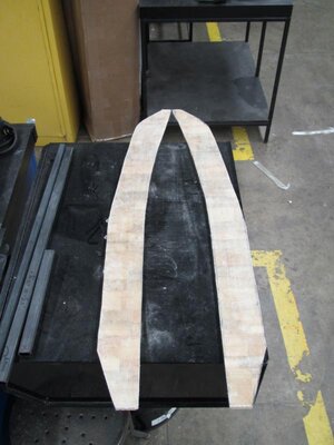

Siderails don't even flinch! Here is what I am thinking for the handle pole :-/
