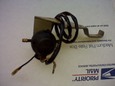

ok figured it out the rpm limiter valve on it is dumping gas back into my carb at a high rate and flooding it until the preasure from the gas line is gone . can i run this ported 550 with out it or is it a nessesity? is it service able ?

$(KGrHqIOKkIE3rv9YtI5BOHn+!dCdg~~_12.JPGfound one on ebay for 40 dollars but would like to know if it has to be replaced. and the local kawi shop techs are out to lunch ...... :p

thanks every one for your help I forgot to check my parts hulls for this part and so i found one the other day in my old 550 sx hull and swapped it out. runnes great now. cant complain i paid 150$ for this 550 and it runs great.
